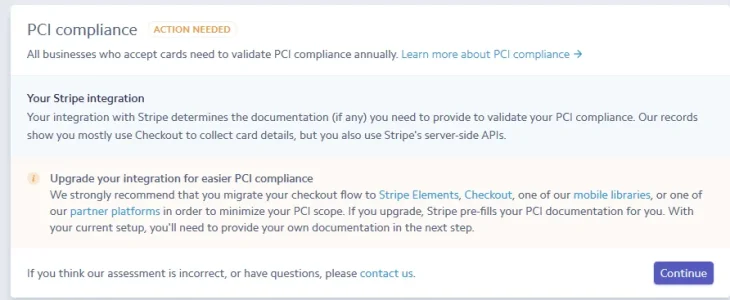

Stripe billing has replaced the old methods. But for Stripe billing PCI compliance is needed. That is why there is this warning:
Since Stripe billing became active a very large % of transactions started to be declined.

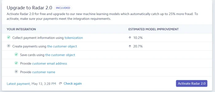

Looking further, its not only Stripe Billing that is new but also Radar 2.0 which doesn't work because customer name is not in the customer object:
Please update this addon.
