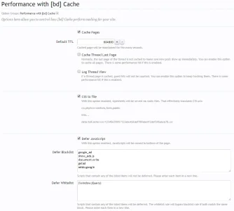

It cache the whole page, so new pages/pagination will not be updated.
It doesn't cache the last page in a thread by default, so unless you check that option (see below that I haven't), new posts should show up immediately regardless of your TTL.
I've always had Cache Thread Last Page enabled and I never noticed new posts not showing up.
