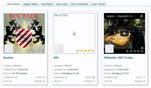

About Xen Media Gallery, since XenForo 1.2, there is attachment thumbnail rebuild tool and that overwrites thumbnail of attachments regardless of the content type and that breaks Xen Media Gallery (because that add-on use custom sized thumbnail). Therefore the add-on generates another thumbnail by itself and that file is what you have found.
The thumbnails in Xen Media Galery are working now, but there is one problem: When I try to rebuild the Attachment Data Storage, the thumbnails for older images are broken. I've uploaded these older images before I used your Attachment Store.

The thumbnails in Xen Media Galery are working now, but there is one problem: When I try to rebuild the Attachment Data Storage, the thumbnails for older images are broken. I've uploaded these older images before I use your Attachment Store.

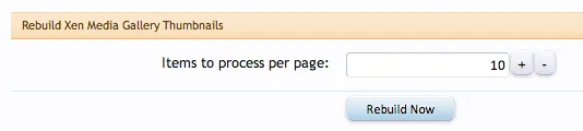

You will need to use the thumbnail rebuilder provided by XenMediaGallery
Like @MattW said, you need to use the rebuilder provided by the other add-on.
This does not help, older thumbnails are still broken. The Image itself is working, but not the related thumbnail. Thumbnails of new images are working, but not the old ones.
