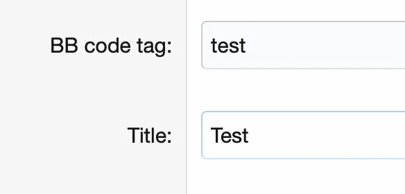

When enteringin the code tag field of bbcode custom editor it should not include the square bracket, ie just test
and the replacement <div class=test ... should be something like <div class="test">{text}</div>

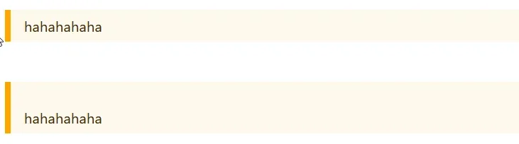

You can see the problem, when doing this:
add bbCode bb with all the needed things to create it.
add css .bb to make bold
add button
Now add a line of text two times, like:
1. text to test with bbcode b
2. text to test with bbcode bb
Now mark text1 and click on b
Now mark text2 and click on bb
The result is
b]Text[/b
and
bb]
Text
[/bb
If you use such a bbCode 50 times a day, you have to correct the line break 100 times a day, top and bottom. I really hate it.
