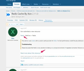

After the update, all the links seem to work correctly except the links created in the first message of the discussions created automatically when adding a resource.
Example: https://xenforo.com/community/threads/redis-cache-by-xon.132179/
Do you have any idea how to fix these links?
