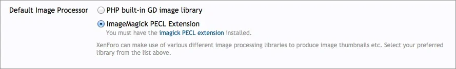

Please verify you have this setting enabled:
Admin CP -> Options -> Attachments
