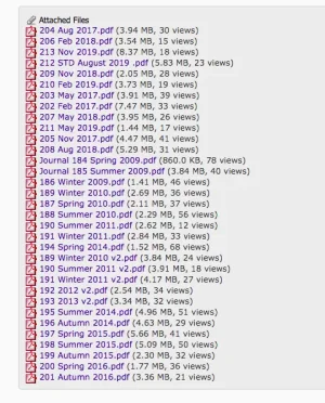

Hello! I migrated from vbulletin to xenforo, and i have question about attachment!
How i can change style for attachments?
Now it's look like this
But i need look like this
p/s sorry for my english!

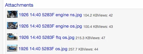

This would result in something similar. Can always adjust the padding/other values to your liking:
Place in extra.less
.attachmentList
    .xf-minorBlockContent();
    display: block;
    padding: @xf-paddingMedium @xf-paddingLarge;
    .attachment
        display: block;
        width: auto;
        background-color: transparent;
        border-width: 0;
        padding: 5px 0;
        margin: 0;
        > div { display: inline-block; }
        i { width: 24px; text-align: center; }
        i:before { font-size: 22px; }
        .attachment-icon.attachment-icon--img img { max-height: 24px; }
        .attachment-name { margin-top: 0; }
        &:first-of-type { padding-top: 0; }
        &:last-of-type { padding-bottom: 0; }
Result is:

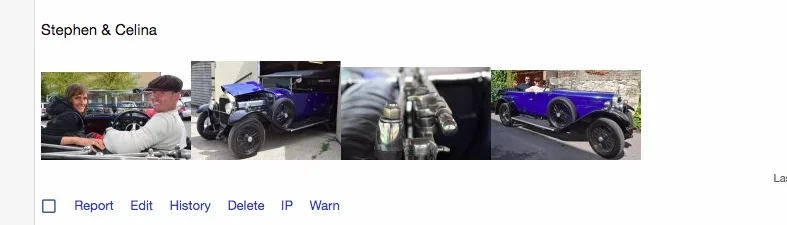

vB did something else that is quite subtle - it displayed image attachments as larger thumbnails and anything else as the above style of list. Of course your clever code displays everything as very small thumbnails. Any thoughts on how the image thumbnails might be displayed in a slightly larger size than other files?
Hi @Russ --
Thanks for doing this -- it looks good. One question though -- it seems to "break" the light-box functionality, where you can scroll between multiple images in a single screen. As I added the code, it displays per your post above, but when you click on an image, it displays singly in a new window.
Thoughts?
Hi @Russ --
Thoughts?

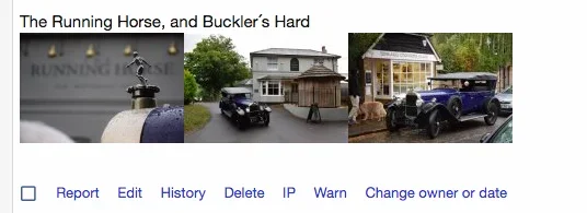

It did exactly the same whether clicking on the thumbnail or the file name - both of them initiated the lightbox view with arrows. It appears to work quite well where there was only one post in a thread with images as attachments. However, you will see below that it also inserted some strange "blank" thumbnails after each image - which actually display as a duplicate of the previous image.
In addition, if there were more images stored in other posts within the same thread, it picked those up too.
All of this was was irrelevant whether the images are inserted within the text, or as attachments below.

1. Showing the first post in a thread with only four images:

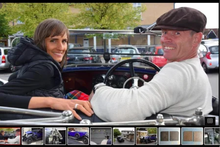

2. Showing how this displays when either the thumbnail or the file name is clicked:
3. Now how it appears when the second (black) thumbnail is clicked:
you notice it is the same image, but the second thumbnail is highlighted.

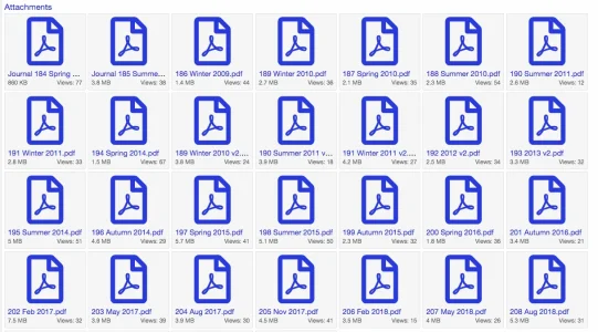

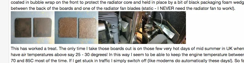

4. Now a thread which contains several posts, three of the posts with images as attachments within the text.
Here's a screen grab of part of the oldest post with its thumbnails shown
next another post (in the same thread) with more thumbnails:
and finally a third post in that same thread with more thumbnails (posted by a different person)

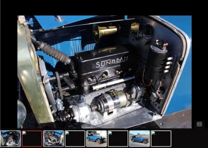

5. When I click on one of the thumbnails in the oldest post, this is how the lightbox looks - note it has picked up all the above thumbnails from all three posts.
when I click through the thumbs, eventually it reaches some where the duplication happens again (with black thumbnail):
Thoughts?

I'd undo my last template edit, probably requires an image inside the link with the lightbox class. Not sure of a workaround on that one, if you notice the attachment you left "un-inserted" it's the same thing, name opens in a new window with the thumbnail as the lightbox.

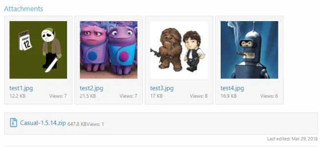

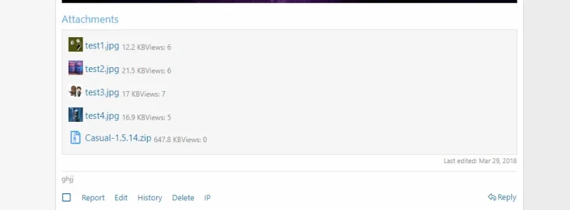

If you wanted to create a different look for attachments vs images... this appears to work.
The result is something like this:
Template:" message_macros"
Find:
<xf:macro name="attachments" arg-attachments="!" arg-message="!" arg-canView="!">
    <xf:if contentcheck="true">
        <xf:css src="attachments.less" />
        <section class="message-attachments">
            <h4 class="block-textHeader">{{ phrase('attachments') }}</h4>
            <ul class="attachmentList">
                <xf:contentcheck>
                    <xf:foreach loop="$attachments" value="$attachment" if="!$message.isAttachmentEmbedded($attachment)">
                        <xf:macro template="attachment_macros" name="attachment_list_item"
                            arg-attachment="{$attachment}"
                            arg-canView="{$canView}" />
                    </xf:foreach>
                </xf:contentcheck>
            </ul>
        </section>
    </xf:if>
</xf:macro>
Replace with:
            <xf:contentcheck>
                <xf:contentcheck>
                    <xf:foreach loop="$attachments" value="$attachment" if="!$message.isAttachmentEmbedded($attachment) AND $attachment.has_thumbnail">
                    </xf:foreach>
                </xf:contentcheck>
            </ul>
            </xf:if>
            <ul class="attachmentList attachmentListCustom">
                <xf:contentcheck>
                    <xf:foreach loop="$attachments" value="$attachment" if="!$message.isAttachmentEmbedded($attachment) AND !$attachment.has_thumbnail">
                    </xf:foreach>
                </xf:contentcheck>
            </ul>
            </xf:if>
            </xf:contentcheck>
        </section>
    </xf:if>
</xf:macro>
Then the CSS:
.attachmentList.attachmentListCustom
    display: block;
    margin-top: @xf-elementSpacer;
    .attachment
        display: block;
        width: auto;
        border-width: 0;
        padding: 5px 0;
        margin: 0;
Hi Russ,
Regarding your latest suggestion - that appearance looks great, indeed that is exactly what I would like it to look like!

Wow Russ, that's a huge success, superb.
And I've now discovered that XF2's lightbox picks up all of the images in a thread when one click's on any image in one post!
So that was nothing to do with your mods! - A red herring!
So, I'm now very happy and relieved - very many thanks!
