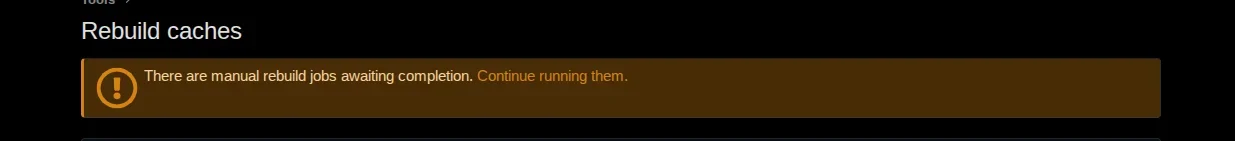

There is a note that there are manual jobs to finish
This is what is returned when I try to re-run
I'm going to guess that I should get the php thing figured? then see if it magically disappears?
