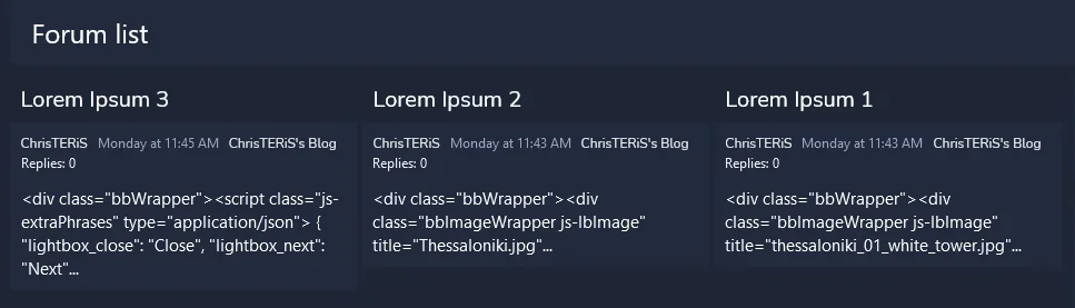

eg This is a widget that I created for last 3 Articles. There is no any option to cutoff the text so the full text appears. The default shows one article per row, but with some custom css I was able to show 3 articles per row, but not responsive.

Thank you for your continued help but the main problem is the long text and secondary I prefer title below the photo and other details in footer like in normal listing.
Tomorrow I'll try to find the original template for article listing and then for widget and I'll try to change it on my own. But for sure a tutorial is much more helpful :) Smarty has a nice function to do it directly to template. eg

In XF you can use {{ snippet($var, 150 }} .
I think that you've a typo, a missing closing ")" after 150. But the problem is that for article body there is no single variable but a function:
{{ bb_code($post.message, 'post', $post) }}
I tried to edit it to:
{{ snippet(bb_code($post.message, 'post', $post), 150) }}
and here is my output:
this means that function snippet works as it shows only 150 characters but most probably I need to replace $post.message, 'post', $post with someting else. I need the variable for the article text and here it has all the code including the photo.
