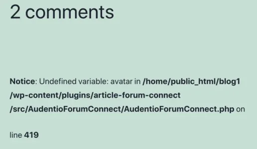

If a User without an Xenforo avatar posts a comment I get the following error in Wordpress:
Notice: Undefined variable: avatar in /home/public_html/blog1/wp-content/plugins/article-forum-connect/src/AudentioForumConnect/AudentioForumConnect.php on line 419
Notice
: Undefined variable: avatar2x in /home/public_html/blog1/wp-content/plugins/article-forum-connect/src/AudentioForumConnect/AudentioForumConnect.php on line 420
That doesn't look to good:
Thanks for reporting this, all my test users had gravatars set up. I'll fix this and make it fall back to a default avatar.

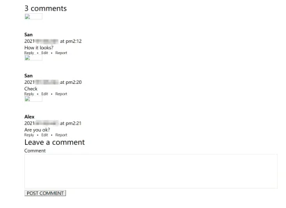

4. After many times testing, now it has a bug: When I posted a comment, it appears 2 times in the comment section and 2 times on xenforo forum.
Anyway, this wordpress plugin is a good idea to replace your wordpress comment section by using something from xenforo. You just need to disable your wordpress registration, it is a great idea. And you can just put your Xenforo Login/register entry to the WordPress portal.
But as I mentioned above, there are at least 4 problems that need to be solved.
