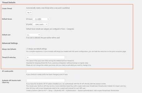

Duplicated posting happened when I canceled the below options and saved them. Later checked all of them, and maybe changed the XF forum from A to B. And also changed the thread ID meta key from 25 to 2.
I think maybe a re-install this plugin may be helped.
How about Article and Forum Connect Plus and Xpress? they are way better and don't have the problems that I mentioned above? I am willing to pay but really need a reliable and nice-looking integration add-on.
Why have you changed the thread ID meta key? That's only really intended for retaining legacy post/thread links as it explains underneath, there is no need to change that otherwise. Changing that is just going to remove the relationship between linked threads so you probably will have issues if you keep changing it.
As I said, you're the first person to report an issue with duplicate posting so I won't be able to suggest anything without even seeing the site. It sounds most likely to be duplicated javascript includes, the only way it would create 2 posts is if it's sending 2 API calls, which would mean 2 requests to the server. Without seeing the site I literally can't suggest anything else.

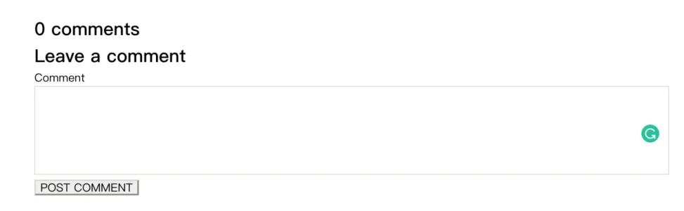

You should then just see the comment box on the posts, I'm not sure what you're doing to get an error message about authenticating a user as you don't do anything like that with the cookie method.
ok, so this is just a comment login add-on?
Yes, either you can use the session cookie integration method to seamlessly post WP comments using your XF user, or the connected accounts integration method to connect your XF account with a pre-existing WP account. There's no WP user creation or syncing.

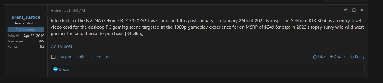

Earlier today, I had an article title cause the plugin to throw a 500 error and killed the post process -
Title: NVIDIA GeForce RTX 3090 Ti Founders Edition and More Custom Models Pictured, 5% to 10% Faster Than GeForce RTX 3090 at 4K, Might Cost “Only” $1,499
It appears there's a 150 character maximum that is thrown by the XFApi but not handled by the plugin:
An error of type E_ERROR was caused in line 396 of the file /var/www/wordpress/wp-content/plugins/article-forum-connect/vendor/xfapi/xfapi-php/src/Client.php. Error message: Uncaught XFApi\Exception\RequestException\NoPermissionRequestException: Please enter a value using 150 characters or fewer. in /var/www/wordpress/wp-content/plugins/article-forum-connect/vendor/xfapi/xfapi-php/src/Client.php:396
Here is a build of version 1.0.3 - bit behind on versions here it seems. I'll be able to prep a full changelog and release tomorrow, but this should address the HTML entity encoding and max length issues (ironically that particular title only hit the 150 length limit due to the entity encoding, was only 147 otherwise :p)
Other changes are just minor bug fixes such as proper permissions for post voting being checked, updating comments counts, and checking for an email address before using it for a Gravatar, but no changes you should notice otherwise.
Awesome! Thank you!
That 147 character title posted correctly with the updated version!
