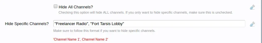

So I have an option here called "Hide Specific Channels?":
The option value is put here in the hideChannels variable.

The problem is that the apostrophes are being outputted as "&#039;" and not as a '. You can see here in the element inspector.
If someone could assist me, I'd appreciate it. (:
I figured it out! If anyone else has the same problem, all you have to do is insert xen:raw at the beginning of your option variable. :)
{xen:raw $xenOptions.optionid}
