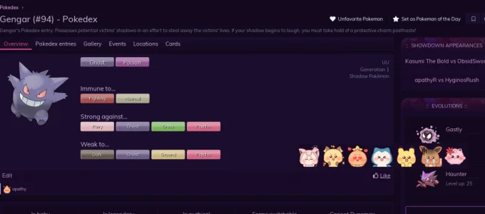

Hi Just wondering how this integrates into the reactions system?
There should be a "Like" button at the bottom of the top block within each content types page (attached is an example for Pokemon pages)
If its not appearing, double check you have the "Can react to pages" permission set for your usergroup
I see the Thumbs up button to react but its just the standard reactions, not the pokemon like yours shows
those were commissioned for my site, theyre not bundled with the addon. it'll use whatever reactions you have set in your admin panel
