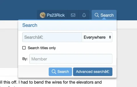

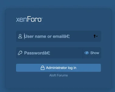

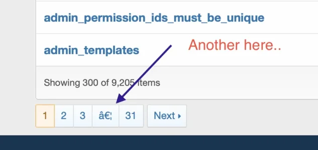

We upgraded from XF 2.1 to 2.1.2 (with the intermediate 2.1.1 done first obviously).. We started noticing this behavior in a few places -- specifically the search box, the Admin control panel fields and in the pagination buttons for threads that span multiple pages. Originally I thought it was the theme we were using but once I switched back to using the default XF blue theme the issues remained as you can see in the attached images. Any ideas on what is going on here would be greatly appreciated!

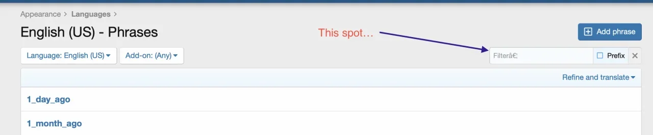

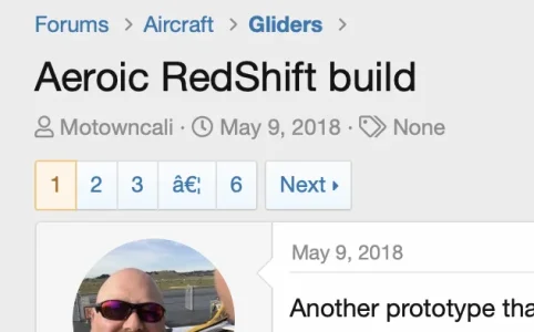

It looks the same as the screenshot above.. no differences. I am seeing this behavior kind of here and there.. A few more screenshots for you if you don't mind.. I'm clueless here.. Any suggestions would be greatly appreciated.. I will state that when I did the two upgrades, that I got merge errors in PAGE_CONTAINER and reverted to the baseline version of that file (I think that's the terminology used) -- we don't modify these parts of the system -- they're always vanilla and unmodified by us. Could it be something associated with PAGE_CONTAINER being messed up?

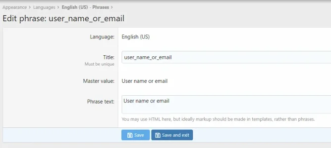

ok.. quick update.. I went poking thru (in Safari w/ Mojave) the generated HTML DOM and found this for the Search box in the upper right corner of every page.. I subsequently went digging through the PHP code and found references to this in the PAGE_CONTAINER template file (./internal_data/code_cache/templates/l1/s2[0..2]/public/PAGE_CONTAINER.php)
So, I gather the offending string comes out of the database and is inserted within the template.. My question is, is it possible that my PAGE_CONTAINER is messed up and needs some TLC..? During the merge it was the only thing that didn't merge properly and I reverted it if I recall. IF that's possible that it's messed up, what's the best way to return it to a vanilla version again as we've never done mods to it. Thanks!
