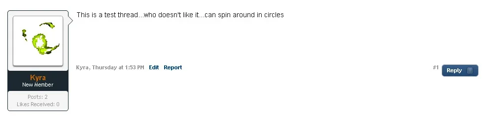

Now, here comes the problem. While I can upload the animated gifs for any user, when they are displayed, not only they are static, but it seems like the gif itself is displayed on a transparent background.
Here is the screenshot:
And the original avatar that needs to be displayed (evidently, the atoms spin around etc):

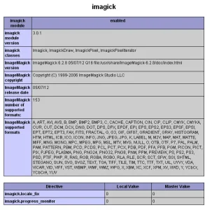

Oh and here's my phpinfo for imagik
a bit of an update...the animated gif in the above example is 100x90 and i deducted that it got this ugly error when doing the resize. i tried uploading a square gif (100x100) and this time, it was uploaded correctly..however, it's still not animated.
