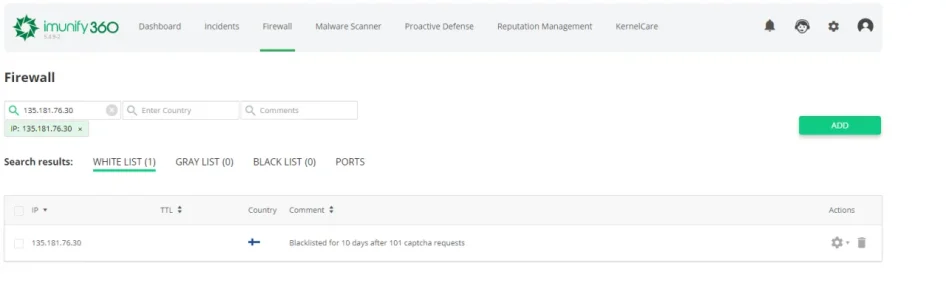

I got an email (Subject: The AMPbot has been paused) saying:
Please fix the problems shown on ampxf.com and restart it
But there were no problems to fix.
So I restarted it. Any reason why I would get this message?
Thanks
This bot doesn't play well with Imunify360. I've already applied a fix to have the bot allowed, however, looking on the server your site is hosted on, the IP was blocked due to too many captcha requests. I've since moved this to the whitelist.
EDIT: Found the blocks, and these happened on this server prior to the fix which I applied on the 7th:
imunify360-webshield]# zgrep AMPXFBot access.log-202*
access.log-20210204.gz:135.181.76.30 - - [03/Feb/2021:19:40:50 +0000] "GET /threads/amprobot.4882?amp=1 HTTP/1.1" 200 20796 site.com "-" "Mozilla/5.0 (compatible; AMPXFBot/1.0; +http://ampxf.com/bot)" WL:"0" "-" XFF:"-" CAPTCHA:"1" PEER:135.181.76.30
access.log-20210204.gz:135.181.76.30 - - [03/Feb/2021:19:41:07 +0000] "GET /amprobot/3dcc3cfa-ae5b-44b5-9ed8-8b9a7ff99c18 HTTP/1.1" 200 20796 site.com "-" "Mozilla/5.0 (compatible; AMPXFBot/1.0; +http://ampxf.com/bot)" WL:"0" "-" XFF:"-" CAPTCHA:"1" PEER:135.181.76.30
access.log-20210204.gz:135.181.76.30 - - [03/Feb/2021:19:41:22 +0000] "GET /amprobot/44faf7d5-b0b3-48f3-bf69-2df13f78d7b8 HTTP/1.1" 200 20796 site.com "-" "Mozilla/5.0 (compatible; AMPXFBot/1.0; +http://ampxf.com/bot)" WL:"0" "-" XFF:"-" CAPTCHA:"1" PEER:135.181.76.30
access.log-20210204.gz:135.181.76.30 - - [03/Feb/2021:19:41:22 +0000] "GET /amprobot/62ce7062-31ef-405b-82b7-868f73dbd669 HTTP/1.1" 200 20796 site.com "-" "Mozilla/5.0 (compatible; AMPXFBot/1.0; +http://ampxf.com/bot)" WL:"0" "-" XFF:"-" CAPTCHA:"1" PEER:135.181.76.30
access.log-20210204.gz:135.181.76.30 - - [03/Feb/2021:19:41:43 +0000] "GET /threads/amprobot.19388?amp=1 HTTP/1.1" 200 20796 site.com "-" "Mozilla/5.0 (compatible; AMPXFBot/1.0; +http://ampxf.com/bot)" WL:"0" "-" XFF:"-" CAPTCHA:"1" PEER:135.181.76.30
access.log-20210204.gz:135.181.76.30 - - [03/Feb/2021:19:42:26 +0000] "GET /amprobot/c41bcaf6-3b56-46ed-a838-d7e773d93f8e HTTP/1.1" 200 20796 site.com "-" "Mozilla/5.0 (compatible; AMPXFBot/1.0; +http://ampxf.com/bot)" WL:"0" "-" XFF:"-" CAPTCHA:"1" PEER:135.181.76.30
access.log-20210204.gz:135.181.76.30 - - [03/Feb/2021:19:42:41 +0000] "GET /threads/amprobot.24166?amp=1 HTTP/1.1" 200 20796 site.com "-" "Mozilla/5.0 (compatible; AMPXFBot/1.0; +http://ampxf.com/bot)" WL:"0" "-" XFF:"-" CAPTCHA:"1" PEER:135.181.76.30
