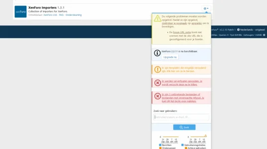

I'm moving my Xenforo installation to a new server (Threadripper - yay!), and I'm seeing a really odd problem.
It seems like every ajax dialog - instead of showing the proper options - just loads the main admin dashboard.
A picture probably illustrates this best:
Same thing for, for instance, clearing the logs.

Looking at the data I'm getting back from the server, it really is just the admin homepage encoded into a json payload. Clearly the routing goes haywire for some reason.
