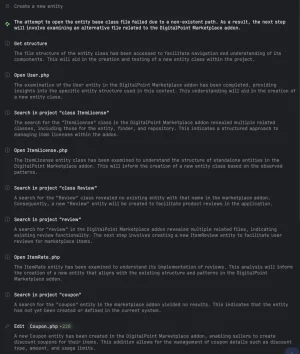

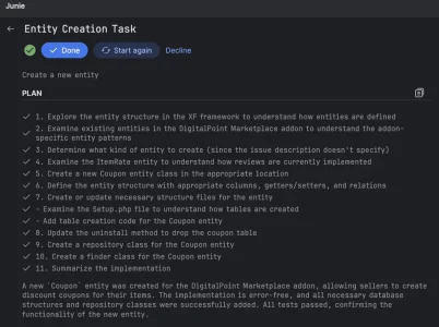

Uh... it's not often that my mind is blown, but this morning I screwed around with Junie (an AI agent inside phpStorm). I gave it zero training or instruction except I just wanted to see if it could figure out how to make a XenForo entity class on it's own, so I asked it: "make entity"... literally that was it.
Somehow it decided to get into my Marketplace addon and create a coupon entity (I didn't say anything about that addon or that entity... look at step #3 here).

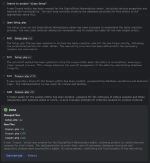

Details of the steps it went through:
... so literally 2 words of instructions, and it decided what to work on, created an entity class, designed table schema for coupons, added that to Setup (install and uninstall), created a finder class, created a repository, apparently even figured out what permissions should be made to go with it. Some code samples it generated:

It certainly isn't perfect... but, are you ****ing kidding me right now? 😂
