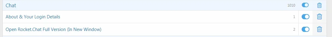

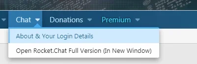

Are you talking about the navigation menu at the top of the forum, like:
You basically want to have a few items such as categories/sections in there show up (as opposed to the chat-related items in the above screenshot - this was just an example)? Is that what you mean?

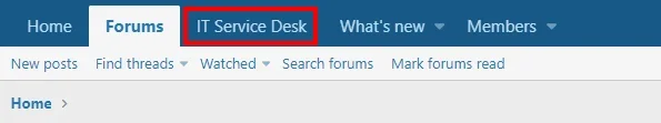

Thank you for your reply, i think i need the top option more.

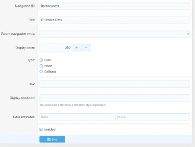

The top bar to show "IT Service Desk" which i have
But then i'm not too sure about the required fields here:
I did originally put
{{ link('service-desk') }}
in the Link field but not sure if thats right? i just guessed from an existing nav menu format but when i click the link i get this:
I guess because /service-desk doesn't actually exist.

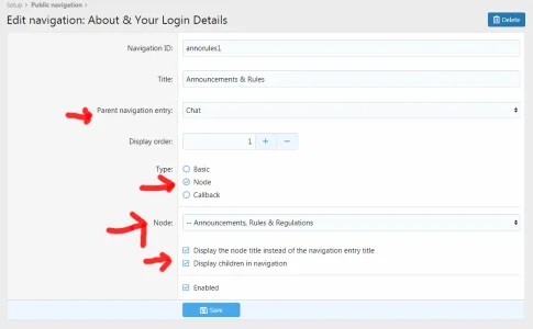

So what you want to do is... for example, here's how my Chat navigation tab is setup:
The screenshot I posted in my previous post is what the above settingswould look like if you view it on the live forum, obviously.

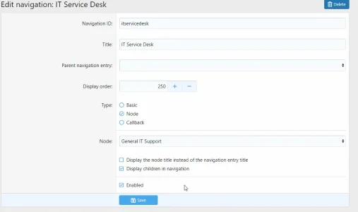

You are close - basically, what you want to do is something like this:
Be sure to select "IT Service Desk" for your parent navigation entry, and configure the other options where the red arrows above are. The main takeaway is to select the Node as the type, and then in the new list that appears, select under "Node:" whatever section/node/whatever that you want to display in the dropdown menu.
You can play around with the other settings (i.e. the other checkboxes shown above) depending on how many categories/subcategories/subnodes/etc you want to show for that specific dropdown as well.
Is that what you're looking for?

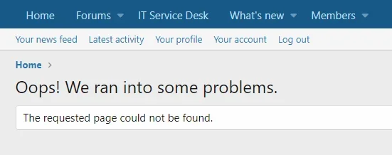

Thank you for your help but still struggling with the parent sorry, the parent navigation shows "IT Service desk" but when i click it i get
How do i configure the parent to show a valid page with another set of forums?

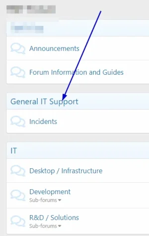

This is the parent navigation which i am linking to the General IT Support category which has a sub forum called "Incidents"

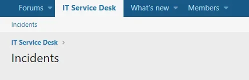

I told a lie early sorry, with the above setup, when i click IT Service Desk in the navigation it goes to /#general-it-support.61 but just displays the main forum page.
If i click Incidents then it takes me to a valid pages and highlights the IT Service Desk navigation
But i would expect when clicking IT Service Desk for it to take me to a page showing Just that one category and forum and that category/forum not show under the main Forums.

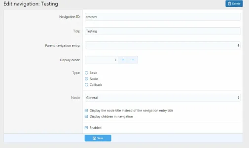

That's interesting. Let me create a test navigation tab on my forum and see what behavior it does - looking at your settings it should operate properly. Will post back shortly.
Okay, I just tested this on our forum and it works properly.
The above points to our "General" category node and the main tab works as well as all child nodes when using the tab.
I am actually wondering if it has something to do with the way you have your URLs setup (or with how your server handles URL anchors)... it looks like the URL you gave as an example which resulted in the 404 "oops" page is trying to visit an HTML anchor instead of the node itself.
