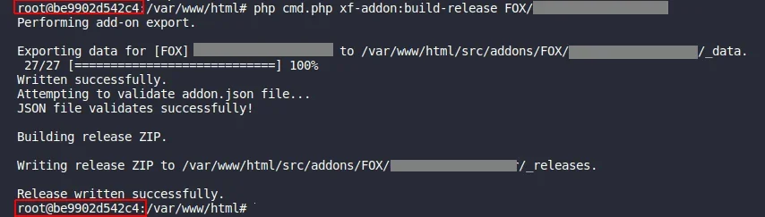

I am building in docker and created using cli "create".

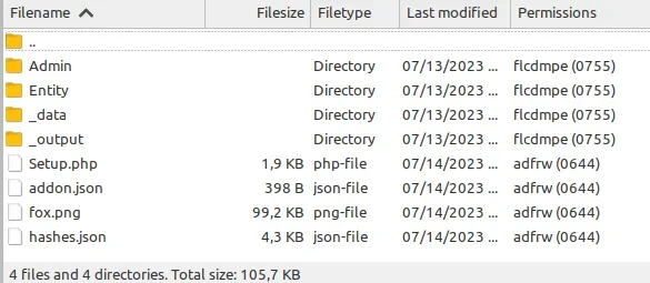

The directories are writable. Here are all permission, should be all 777?
Directories are 777
Setup and addon.json 333
Files in _data 344
It's generated when you build the release... with CLI it's the php cmd.php xf-addon:build-release command (it includes it with the installable archive). It's a hash of every file in your addon and that hash changes anytime a file is edited, so it wouldn't make sense to generate that on addon creation (before there are any files).

If the hashes.json file isn't in the root directory of your addon for whatever reason (the same directory that the addon.json file is in), the option to delete it from the admin control panel won't be presented to you (it doesn't matter if it exists in a zip file).
The hashes.json is present in addon directory after installation from zip file, so it should show the delete option, right? But still can't see.
It's one of a few things... depending on the "user" your web server is running as, maybe it doesn't have permissions to delete that directory since it looks like permissions are 0644 for some things in there. Without knowing the web server "user", you could make the directory and everything in it 777 as a test (then any user can delete it). If you installed the addon manually (uploading the files) and didn't install it from the admin control panel, it's probably a permission issue (if you install it as the web server "user", you should be able to uninstall it too).
