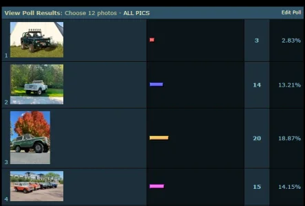

Here's an example of what it looked like using vBulletin:
Thanks Nicodak. Unfortunately that addon won't work for my needs. I gather up all the photos first, then post the poll to vote on them.
Ideally I would be able to include HTML or BB code in the poll options.
