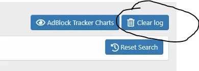

@Stuart Wright, thanks for bringing this to my attention. For an immediate solution you can clear the all the tracking logs, or, remove all the guest tracking using the "Clear log" feature.
I'll implement an update to use the cron to:
  • automatically clear for records over XX days stale
The above should prevent the table from collecting tens of millions of stale entries

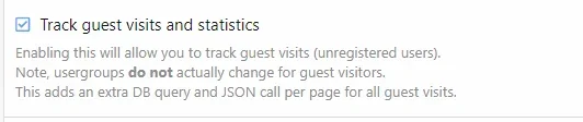

@Stuart Wright you can also, moving forward, disable tracking of guests completely to save building up lots of stale guest tracking.
If you disable the option below I would recommend "Clear log" for "Guests" after unchecking the box below in options.
Did this and most of the records were deleted leaving just 57,000. So 99.5% of the records were from guests.
