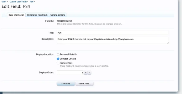

Change $user.occupation to $user.(fieldname). Check the field name at Admin Control Panel -> Users -> Custom User Fields -> Click on the one you want -> Copy the field id.

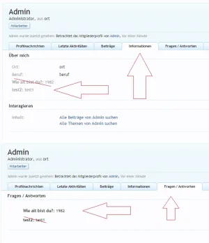

I have done it without problems. Only I have a problem that the questions which I've now created under the tab about to other user information fields are displayed now and that should not be. Do you have an idea?
Got a screenshot?
Have 2 different user fields, once the questions under your tab and then other information.
@Pinn Oh, I see. There's another template modification I used to remove them from the information tab. Let me install this real quick on my new development board and check it for you.
@Pinn Hm, I completely overlooked this part. Fields are added through a loop. There are a couple of ways to remove them. The proper and the recommended way would probably require PHP code. If you wanted all of the personal user fields moved into the about tab, it's a lot easier. To move specific ones would require some PHP code accustomed to your installation (or a selector in the Options part of the panel, which shows all custom fields and allows you to select which ones should go under About, which could come in a future update).
