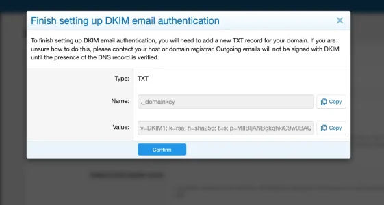

Hi,
I'm having issues with DKIM verification.
As far as I remember, earlier the record used to look like xenforo._domainkey, but now when generating it just shows ._domainkey.
Previously the verification would pass in about 2 minutes, but now it's been over an hour and I'm still seeing this message:
"Attempting to verify your DNS record but it may take up to 24 hours for DNS changes to propagate. If it has been longer, you may need to verify your entries."

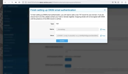

The DKIM issue still remains in XenForo version 2.3.10. Today, out of curiosity, I created a test forum: https://d2e5f7551ef1e29c.demo-xenforo.com/2310/admin.php
(You may log in as the administrator with the username admin and password admin). There, the system similarly generates ._domainkey instead of xenforo._domainkey. After that, I wait 24 hours and still receive the same error.
@Chris D

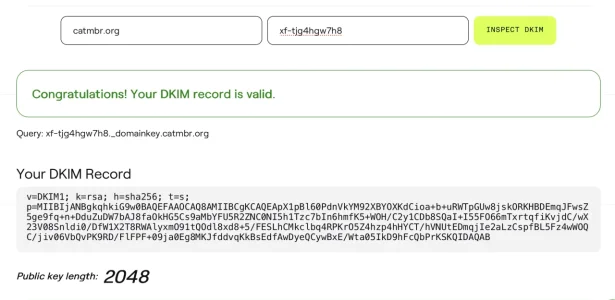

Update: The XF DKIM setup gave me the selector "xf-hax_8as30l". I ran the DKIM test on easydmarc.com, mxtoolbox.com and then https://dmarcian.com/dkim-inspector/. The last one says the following:
There is something wrong with your DKIM record.​
DKIM selectors must not contain underscore characters per RFC 6376. Compliant receivers are likely to ignore this invalid DKIM record, or simply declare its usage as 'fail'​
So, this seems to be an issue with the XF selector name generation, at least when it does not give you '._domainkey' as a selector, or 'xenforo._domainkey'. We do not seem to be able to select our own domain selector here, so I can't test different values.
I recall that the previous couple of non-default domain selectors it generated, also had underscores in the text after xf-{string}.
@Anthony Parsons Does that work only if XF decides that "._domainkey" is the selector?
This morning I selected 'change' again in the DKIM authentication setup panel. It gave me a selector without underscores, so I updated my DNS accordingly. Two minutes later, I got a 'valid' result from dmarcian.com. Meanwhile, my XF installation is still stuck in the "attempting to verify" state...
So, there must be something else not going right here. I copy-pasted the selector and the record itself directly from the XF setup panel fields.
