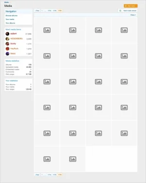

Trying to fix an issue where thumbnails are broken.
I have run the XFMG: Rebuild media thumbnails, but it does not work.
