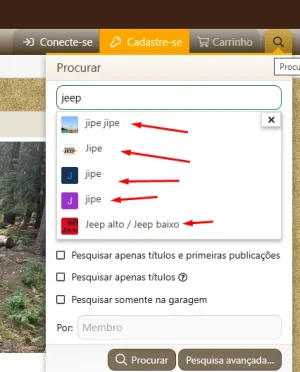

I have a forum with 48k topics and Enhanced Search 2.3.5 installed; everything is working fine.
When I search for "Samsung," nothing appears—not even "Samsung" itself.
My question is: how does the enhanced search scope work so that results appear while I am typing my query?

Any search query—e.g., "Dell," "Samsung," or "E1"—fails to return results.
This image shows the expected outcome (XF).
Do I need to have over a million topics to get a result like the one in the image?

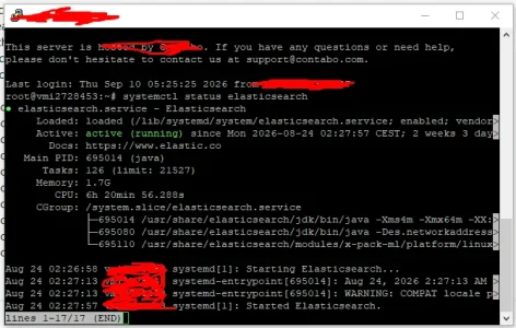

You HAVE to have elasticsearch running. To check use ssh and run the command to check the service. Here is a typical reply.
Enter: systemctl status elasticsearch
[root@server ~]# systemctl status elasticsearch
● elasticsearch.service - Elasticsearch
Loaded: loaded (/usr/lib/systemd/system/elasticsearch.service; enabled; vendor preset: disabled)
Active: active (running) since Wed 2026-09-09 19:24:08 MST; 45min ago
Docs: https://www.elastic.co
Main PID: 486 (server-launcher)
CGroup: /system.slice/elasticsearch.service
├─ 486 /usr/share/elasticsearch/lib/tools/server-launcher/server-launcher -p /run/elasticsear>
├─1154 /usr/share/elasticsearch/jdk/bin/java -Des.networkaddress.cache.ttl=60 -Des.networkadd>
└─1240 /usr/share/elasticsearch/modules/x-pack-ml/platform/linux-x86_64/bin/controller
Sep 09 19:23:12 server.jeep-cj.com systemd[1]: elasticsearch.service: Succeeded.
Sep 09 19:23:12 server.jeep-cj.com systemd[1]: Stopped Elasticsearch.
Sep 09 19:23:36 server.jeep-cj.com systemd[1]: Starting Elasticsearch...
Sep 09 19:23:40 server.jeep-cj.com systemd-entrypoint[486]: Failed to load native library:jansi-2.4.3-db>
Sep 09 19:23:40 server.jeep-cj.com systemd-entrypoint[486]: java.lang.UnsatisfiedLinkError: /tmp/elastic>
Sep 09 19:24:01 server.jeep-cj.com systemd-entrypoint[486]: WARNING: A terminally deprecated method in s>
Sep 09 19:24:01 server.jeep-cj.com systemd-entrypoint[486]: WARNING: sun.misc.Unsafe::arrayBaseOffset ha>
Sep 09 19:24:01 server.jeep-cj.com systemd-entrypoint[486]: WARNING: Please consider reporting this to t>
Sep 09 19:24:01 server.jeep-cj.com systemd-entrypoint[486]: WARNING: sun.misc.Unsafe::arrayBaseOffset wi>
Sep 09 19:24:08 server.jeep-cj.com systemd[1]: Started Elasticsearch.
lines 1-20/20 (END)
[root@server ~]#
@philmckrackon
Your forum is working correctly.

That live search result on XF looks exactly the same as the one on my forum.
