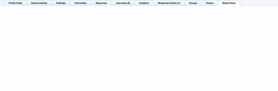

So I upgraded from Better Blogs 1.0.33 to 1.0.44. I did encounter a small issue, however.
On the Member profile tab that displays blog posts on their profile page, it no longer shows blog posts. It did before the upgrade. Normally it would show a loading message for a few seconds but I just get white space, even when toggling between tabs.

Any ideas on how to fix this?
Hello.
A link? I would take a look. The link in your profile page do not work.
But I can say, in this version - I only change certain litle Style issues and add a hand full phrases. No other code changes to the original "Better Blogs" ...

I'm pretty sure it has nothing to do with the changes you've bad. I think it was a change made between the Better Blog version I was running and one of it's updates (was running a relatively outdated version). I'm wondering if anyone else experienced this - or at the very least, are your installations properly showing the blogs in the profile tab? It might be a styling issue on my site or an issue involving my other profile tabs, but I don't see why if it worked fine before upgrading this add-on alone.
... as I wrote on https://xen-hilfe.de its a style issue with the used Flat 4 style in combination with a deleted or overwriten Xenforo default style. Not a issue in the Simple Blog addon.

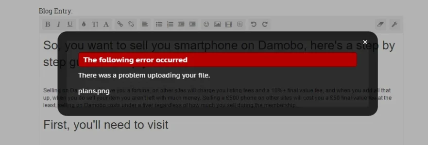

Having an issue where I can't upload images and getting this error:
  • Fresh install, XF 1.5,
  • Permissions all set up correctly,
  • Using PHP built-in GD image library
I have an account if you need access to see whats causing it let me know. I really need this fixed asap :( I'd appreciate it. I'll throw $10 your way for a quick fix.

I dont think there is a fix needed on side of the add-on yet. I have tested it several times and the image uploads works very well. It uses the built in xenforo image upload to do this. ;)
- Comes this error with every file type? jpg, bmp, gif eg or only with pngs?
- Is this only in the blogs? In all blogs? In all groups?
- What version of php, gdimage, xenforo you use, what other add-ons you use?
And last but not least - Simple Blogs is for free and my support is for free. Its a project after work for me. ;)

- Seems to be happening with all image types.
- Happening in all blogs and groups
- Using Xenforo 1.5.8 & On a Shared Hosting plan by Godaddy so most stuff is up to date.

I sent you some admin login details via PM, if you could take a look I'd be forever grateful.
edit: just disabled most addons and still having this issue on both default style and the style I am using.
edit 2: After disabling flash uploader, I now get this error:
