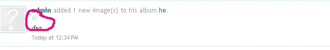

I want to change the news_feed(Recent Activity) of this addon
http://xenforo.com/community/recent-activity/
When I upload photos.
It updates new feed " admin added 1 new image(s) to his album he" and don't have image thumbnail.
I want to edit to add image thumbnai
I tried code " <img src="{$image.thumbnailUrl}" alt="{$image.filename}"/>" But I was not successful.
@Brogan and @Jeremy
I know this addon which are not developed by your
But You are better than me.Can you help me?
This addon .it is not being developed anymore.I was really sad
In templates " xfr_useralbums_forum_list_image "
Have the code
<div class="thumbnail">
<a href="{xen:link useralbums/view-image, $image}" class="thumbBox ImageboxOpener" data-href="{xen:link 'full:useralbums/view', $album}#image-{$image.image_id}">
</a>
</div>
Code {$image.thumbnailUrl}. it is used to call Images thumbnails
I copied it into the teamplate"news_feed_item_xfr_useralbum_image_insert"
Do you have any idea to help me?
Thank you very much

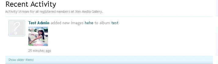

Having developed the add-on you see in the second screenshot, it's not easy to do unless you modify PHP files. It's likely the news feed handler doesn't pass the thumbnailUrl parameter to the template.
You're more than likely going to need to:
  • Use another add-on
  • Pay someone to make the customisations for you (post a request in the relevant forum)
  • Or wait patiently in case the developer of this add-on or one of its users helps you out.
You're not likely going to get help by tagging people who don't even use the add-on...
