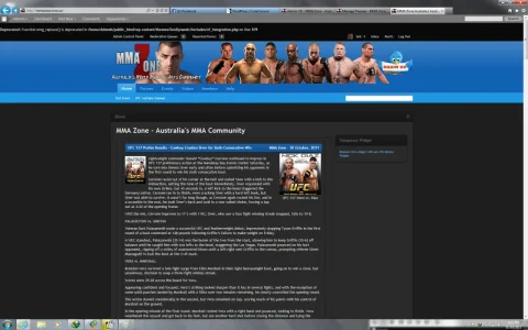

I get some weird error at the top of the screen, not sure what it means? screenshot below

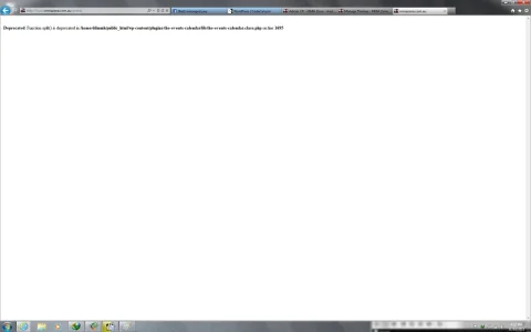

I noticed this doesnt work with a premium WP plugin. Event Calendar pro 2.0(came out a few weeks ago) screenshot of error below

Both errors in that screenshot are telling you that the scripts you are using (this mod and this WP plugin you are talking about) are using some outdated code that could be replaced by something faster or better or more secure in some way. They are not actually telling anything has faield to work, it's just a notice for the person who made the script to update it.
I think you can force your server to ignore the error and not display it by adding "error_reporting(0);" to the top of the PHP file the error is refering to. (After the "<php" tag. )
I'm not too good at PHP myself, but I think that will work. (untested)
It's sort of notice is more likley to happen when you are using a really bleeding edge new version of your webserver with PHP addon.
Thanks for that. I realised after I posted in here that the first screenshot was probably just PHP reporting errors which I need to turn off.
As for the 2nd screenshot I hope Bambua finds the time to make it more compatible, this has great potential.
Thanks for your help Anseur
The second screenshot is because of how I supressed the errors in XenDynamic, I can adjust it and probably should so you don't see the depreciated line. As for the tubepress error, can you send me a link to where you have it running? It looks like it's just a CSS issue.
