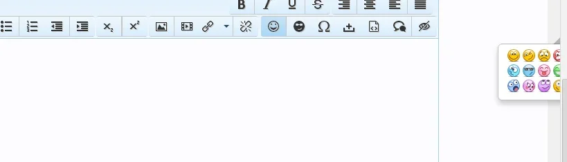

hi i just found an issue with RTL forum
when i click on smiles or add links all window open on the most right
but when its LTR its goes in the center or as should be placed
also i add it here
https://github.com/cclaerhout/xen_TinyQuattro/issues/3
It seems the problem comes from the custom XenForo theme I've done. I will have to check it, but that's not my priority. You can just use the default TinyMCE theme and it will work. To do that, read the paragraph 5 of the FAQ.
@TBDragon
This problem is because XenForo has an automatic function to convert some 'ltr' css properties to some 'rtl' css properties AND TinyMCE is using the traditional way to specify some css for RTL languages. When TinyMCE gets the modified properties, there's a clash.
XenForo has a feature to disable the automatic conversion but it's property by property (just need to add "rtl-raw." before the css property). There's no way to skip a block of code inside a template. So this would mean to find all properties that would be modified by the XenForo automatic conversion system, then to add before them this prefix: rtl-raw.
Let's make it simple, I'm not going to do that, that would take too much time and more over, that will make the css code ugly. So if a theme is using the "XenForo Style Properties Integration" option for TinyMCE and the user language is a RTL one, I will force the script to use either the original TinyMCE skin or the theme with the XenForo colors I've published on the XenForo website. The first solution would require less work.
