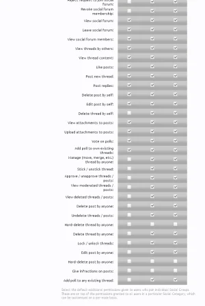

I'm having some trouble setting up my permissions. Here's what I have:
Options page
Registered Users (Usergroup Permissions)
Registered Users (Social Group Node Permissions)
Basically, I want users to be able to (for example) edit the title of only the group(s) they create or moderate. However, it seems that it's either all or nothing when I set up permissions--either they have creator/moderator power for all groups (not just the ones they create), or power in none. I've been trying many variations of the settings but just can't get it right.

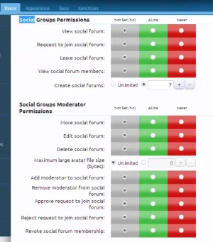

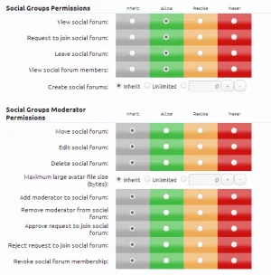

@mistypants, the image you have sent is cut off just where it matters, so I can't see if your settings are correct.
The option you need to have set correctly is the 'Edit social forum' option, which should be set as follows:
You then also need to make sure that they haven't been given that permission in your node/user group/user permissions. From the images above, you appear to have this set correctly.
Unfortunately, there is no separate permission for editing the different parts of the group -- they can either edit all the title, description, style override etc., or they can edit nothing.
Hope this makes sense.

Woops, don't know why that happened. But Edit social forum was checked for Creators only, I checked it for Moderators also and had my users check and all is as it should be.

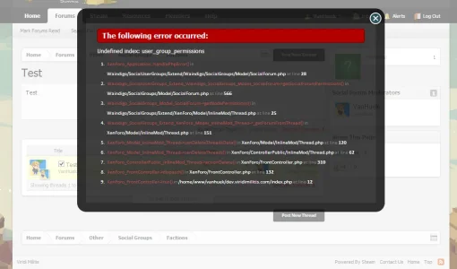

Does anyone know what:
Undefined index: user_group_permissions
Would be caused by and how to fix it?
I am the admin of the forums and I stickied a social group and now get:
and also when I try to delete a thread, through moderator tools I get:
Edit: found out the second bug is related to social user groups, so removed for now - as they weren't working anyway, as in couldn't add more usergroups for some reason :(
