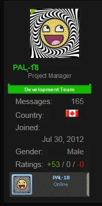

I figured out how to do it myself (to get it to display at very bottom of message info), so here it is for everyone else:
Create a new template modification in your default style or the default styles' parent style:
Template: message_user_info
Modification Key: SteamStatusUnderInfo
Description: Steam Status Under Info
Find:
<span class="arrow"><span></span></span>
Replace:
$0
<xen:include template="steam_profile_message_info" />
Then in Options->Steam Integration, check "Display Steam Profile in messages" and save.
And here's what it will look like:
