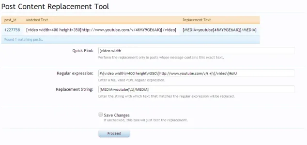

Can you show a screen shot please? I tested it exactly as above, and it replaced the post
Yes, when i search it shows correctly when i run it. It shows the error.
here is the screen shot..
@Arun Kumar
@MattW
The error usually means the resulting post is empty which is not allowed. But your replacement is not "empty". In looking at the code, this could also be the result of invalid BB code being stripped away at render time. It's probably the ampersand in your video id that is getting matched. Your regex needs to be tightened. Replace the (.+) with ([a-zA-Z0-9_\-]+)
The bottom of the screenshot shows a post with multiple matches. The UI for this addon puts the post link into a cell with a rowspan > 1 when there are multiple matches. It's not missing, it's just outside of the screenshot.
Thanks Jake, I didn't notice the lack of lines between the matches in the screen shot.
