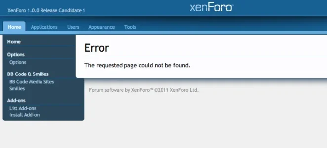

This is just what I need, but I can't get it to run. Uploaded folders and contents to corresponding folders in /Xenforo/Library. Installed .xml file as usual. Here's what I get when I click on Replace in Posts. Anybody know what I'm doing wrong?
