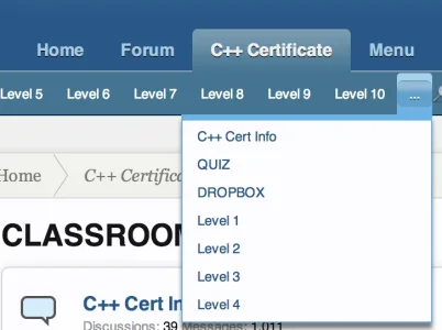

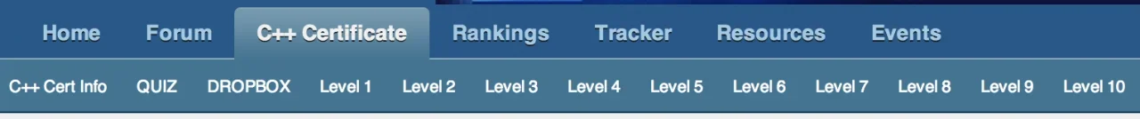

When in full width, the sub menu shows forums going from level 1-level 10
When you resize the windows or in mobile, the submenu would shrink and it display level 5-level 10 with level 1-4 appears in the dropdown. I believe the expected behavior would be that the first 5 level would shows and the dropdown contains the rest?
@Jake Bunce
Probably a bug
Link to reproduce the bug
The responsive style does that on the default tabs as well. You could post this as a bug report for XenForo if you want.
