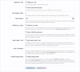

I made a navigation tab with these settings...
AND now I can't remove it :/
That screenshot is nothing to do with this add-on - that is from another add-on.

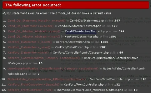

I made a new Category node ALL CIRCLES/
root node/ Display Order=1 / Order=1/
All the NodeTabs options selected except "Add "Mark Read" Link"
I get a big error screen
That's an interesting error. This looks like a problem with your database and not this addon. I would like to examine your database if you are comfortable giving me FTP access to your server.
oops ok, right.
Ok thanks.
The error was caused by the "User Group Notification (waindigo.com)" addon. I fixed it by disabling that addon in your Admin CP.
