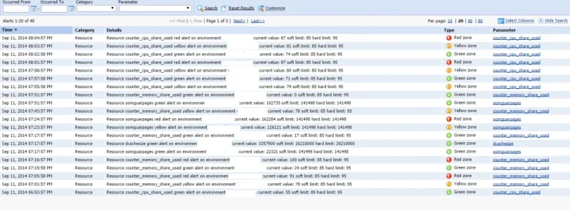

I found this in my ControlPanel
I contacted my hosting company. And they said my cpu was maxing out. It only maxes out when i press on proceed. I think there should be a way to only do a certain amount of threads. About 10-50 at a time or less.

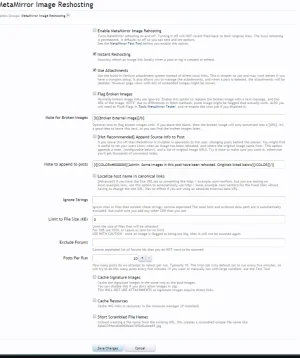

What settings do you have in the ACP for the add-on? Is it crashing when you test the add-on per the instructions?
These are the settings i used. I followed the instructions.
I couldn't get past this part. I pressed proceed. It would go and seem like it working for about 2 - 5 minutes then it would go on internal server error. While this was going my forum would become really slow and pages would take forever to load.
The test forum would work perfectly. But like i said before my test forum only has 100 images. So it scans it right away. But 1 million BB Tags. Wouldnt that take forever? or time out?
The settings show to only process 10 images per run? So I assume it shouldn't matter per instance of the cron running that you have 1 million linked images, it should only be attempting to locate and rehost 10? With 10 being processed every 5 mins you are looking at approx 695 days to run through them all o_O

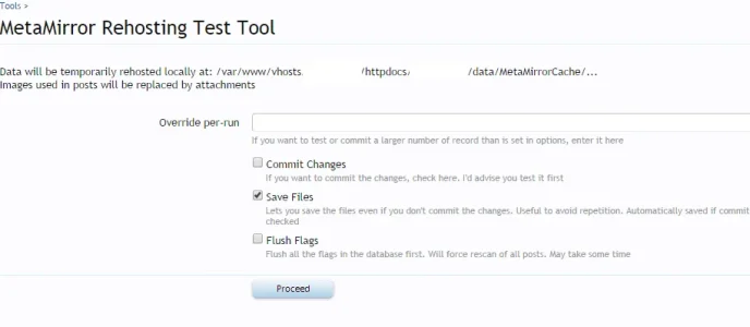

Well i tried it again. This time i shut off my board. And i changed the "Posts Per Run" to 1.
I then went to "Proceed" on the Test Tool. When i press Proceed. I see this circle thing:
After about 1 or 2 minutes i get the blank page with "Internal Server Error" I kept a look at my cpu usage. It goes up from 23% to 90% while doing this operation. And then i unable to access my forum as it runs super slow. Then it goes blank and i have to restart my server.
