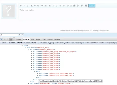

I have the TinyMCE only on the more options page. So I have not 2 editors on one page but the fast edit has not the buttons who I have added only on the fast reply.
No, once you've enable TinyMCE for 1 usergroup, it is enabled everywhere. If you want to enable Redactor back to the quickreply you will have then to enable it too with the inline edit.

Oh, I found it now why it is not working. I forgot to add the XenForo_ViewPublic_Post_EditInline to the editor config, sorry. :notworthy:

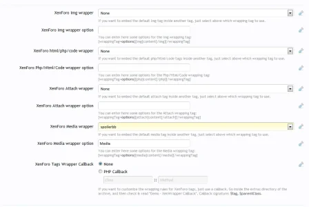

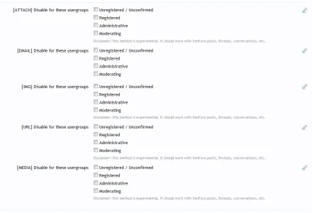

Cedric @cclaerhout I have a question regarding the "XenForo html/php/code wrapper" feature. Would it be possible to hide / not show the content of the tag for spesific usergroups? Only valid members could see the content & BB code... A message could be shown instead.
I realize there are one or two addons that do this, but they are not supported & not up to date. Would you consider adding such feature if it doesn't already exist?
There are sooo many options :ROFLMAO:
  • For the Official Bb Codes (except the 1.3 spoiler tag), it's already possible to:
    1. Wrap them inside another Bbm Custom Bb Code
    2. Disable them by usergroups
    These options are (logically) inside the menu "Bb Codes options (Xen)", since there are options for the XenForo Bb Codes.

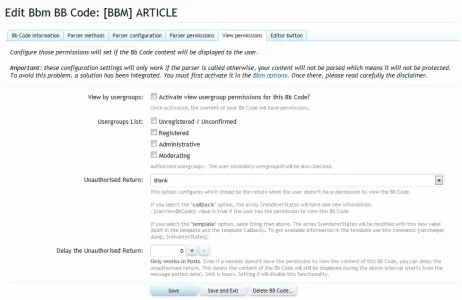

  • For the Bbm Custom Bb Codes, it's already possible to:
    1. Enable the parsing permissions by usergroup (experimental feature ; why ? Because the code is quite very hacky to perform that)
    2. Enable the viewing permissions by usergroup
    3. Wrap then inside another Bbm Custom Bb Code
    These options are (logically) available inside each Bbm Custom Bb Code options.
  • I will not add parsing/viewing permissions for the Official Bb Codes. But you can still create a BBM custom Bb Code (a basic block), give it some viewing permissions. Then use the XenForo Bb Codes wrapping option to wrap this Bb Code inside the Bbm Bb Code you would have created.

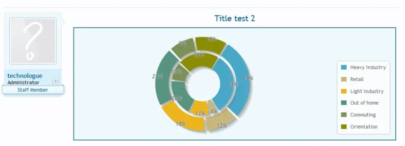

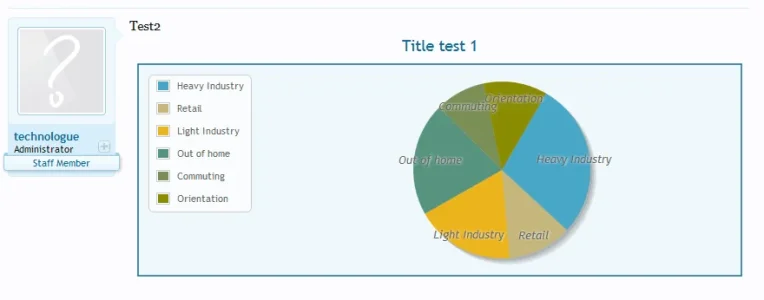

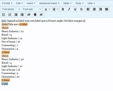

I plan to release a new version with only a few Bb Codes helpers.
Now here's one of the reasons (early preview):

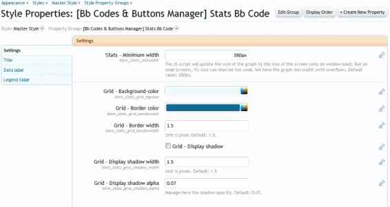

Cool! Excellent! WOW! Thank you, and i'll be waiting. ;) This is work in redactor?
I've already told you (with the Buttons Creator Bb Code), that's a Bb Code, so the editor doesn't matter. And I'm not sure I will make an user interface for this one (on TinyMCE), that would be very complex and would take too much time.

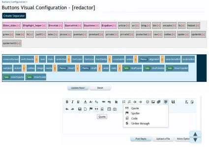

I don't understand your problem description. Please provide some screenshot of your Buttons Configuration. I don't have much time, so if you can contact me in pm with your website, and admin access to the Bbm configuration and, if the problem is confirmed, a ftp access to the bbm libraries, that would be faster. Thanks.
the screen shot was right in the link I provided.
sorry.. I misread..
