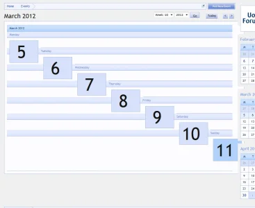

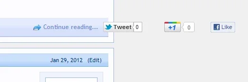

Another question, I'm going a little insane trying to fix this.
I've got two slight style issues, one with XenPorta and one with XenAtendo, the issue only arises in IE (I'm testing in 9).
Social icons out of place on articles from the recent news blog

Xen Atendo Weekly View
After checking a few other sites that use these add ons it must be something I'm doing weird or wrong as I don't experience this problem with them. I can't figure it out though, the issues are still there when I revert to the default theme too.
I've tried removing everything from extra.css, disabling every add on but the ones in question, checked all my template edits for possible mistakes (there's not many edits).
Any ideas?
I'd start with default theme (installed fresh from master) and disabling all other addons. If that gets you no where then time to turn firebug on and work out the CSS that's causing it.
Thanks Rob, I've justed had 3 friends test it on IE on their PCs and it looks like it's just a problem with my computer is it displays fine on theirs :rolleyes: I wish I'd asked them sooner :cry:
Running Win 7 with the latest IE9, how strange o_O
