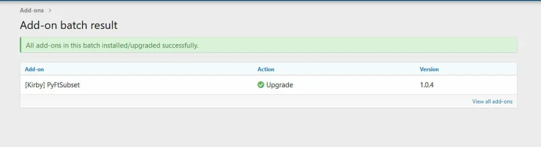

@El Porcharo
If it's been working fine so far why did you try to "upgrade"?
There is a big, red warning in the update notes
Coz I'm an idiot 🤣
I must have confused the update to be safe on FAM's thread and I upgraded both 🤦🏻‍♂️
I think I'll go for option (1), will try reinstalling previous version over this one.
Thanks buddy 👍🏼
