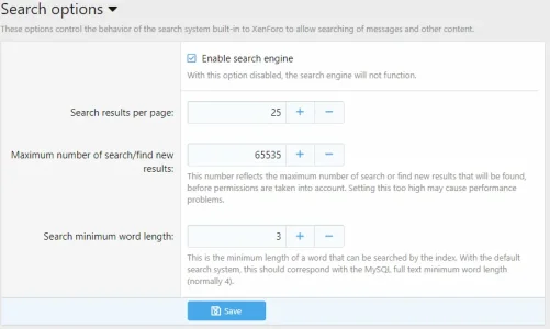

Here are our search options for Xenforo ( enhanced search is all set to defaults and also, our ES is bone stock as well )
Elastic Search doesn't seem to be taking the above setting into account. How can i make elasticsearch look deeper than 400 pages ( 10,000 posts ) when searching through a user's history?

Turns out this 400 page limit correlates with a maximum of 10000 find results ( 25 x 400 = 10000 )
Setting it to 15000 still returns 400 pages.
Without elastic search on on our development copy, setting the maximum results to 25000 gives 1000 pages as expected.
How can i remove this artificial limitation of enhanced search? we have the horsepower to handle the size, and an incredible amount of content.
It's not exactly an artificial limitation. Elasticsearch will run into performance issues beyond 10,000 results, and the search system does not offer cursor-based pagination (ie. search_after). Further, things like the find-new system do not use Elasticsearch at all and a limit that high is liable to cause performance issues with MySQL. My only recommendation is to narrow your search using the newer than/older than filters when necessary. I'm not sure how much utility there really is in an exhaustive listing, but the search system was not really designed to accomodate this.
