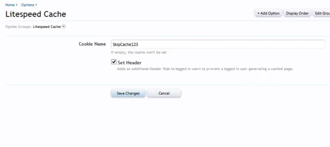

Slavik updated XenForo LiteSpeed Cache with a new update entry:
1.1.0 Release
Contains a variety of improvements.
  1. No longer logs users out on install
  2. Allows alteration of the cookie name if desired
  3. Adds a no-cache header responce to prevent logged in users accidentally generating logged-in cached files for guests.
  4. Improved .htaccess rules to be more re-write friendly when used with other rules.

@Slavik forgot to say, that since version 1.1 this addon includes a new options group "Litespeed Cache"
