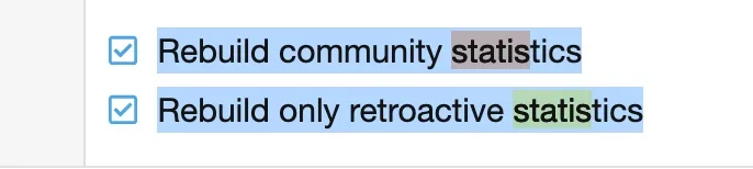

Can you explain what these two options do and how they are different?
The “Rebuild community statistics” option also updates the overall statistics for the forum, not just the personal user statistics.
Retroactive statistics are user activity and thread views - it is best not to touch it for older years in order to preserve more accurate information.

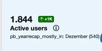

Bug in the frontend: Missing Phrase in "active users": shows "pb_yearrecap_mostly_in" instead of the phrase.
Fixed itself after updating the caches for each year w/o checking the second option there:
The updating w/o the second option was necessary to show the newly calculated threads view counter.
Monthly distribution of the tread views is however missing (was there before), however, this is not a dealbraker.

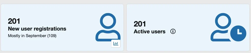

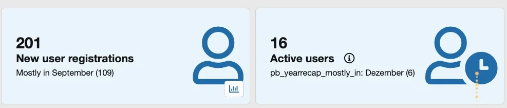

Active users for former years is fixed as well: I started my forum only in 2022 and the numbers of registrations and active users did not fit:
After the cache rebuild they do now:
Thanks for the update and for the speed of it!

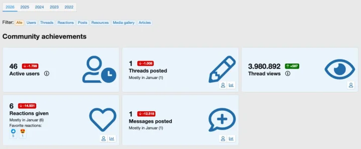

Recalculation for the new year 2026 seems partly delayed: 10,5 hours into the new year and sadly there's no way my forum had 4.000.000 thread views over these couple of hours. :p (in fact this number is - in opposite to the others - from 2025.

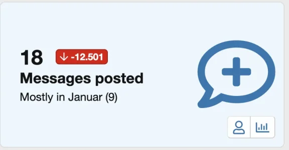

@Painbaker : Calculation of messages seems to be out of line, too. Currently the 2026 stat claims:

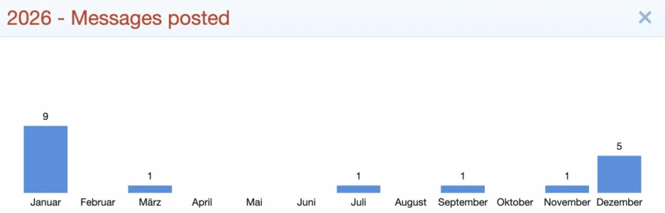

The monthly overview for 2026 is however off the track and shows messages from today in future months:
