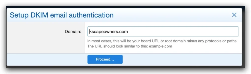

I go to ACP->Options->Email Options and click Enable for DKIM option.

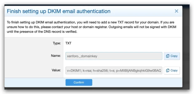

I get this box... and enter my domain properly (actually, it prepopulates the domain properly in this box, and i leave it as is):
I click Proceed and get the popup with the info I need for the new TXT record to add to my server:

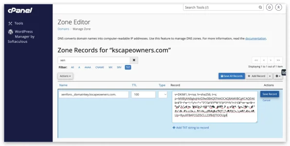

I follow the steps EXACTLY... I go to my cpanel at my host and access:
cpanel->Zone Editor->{my domain}->Manage:

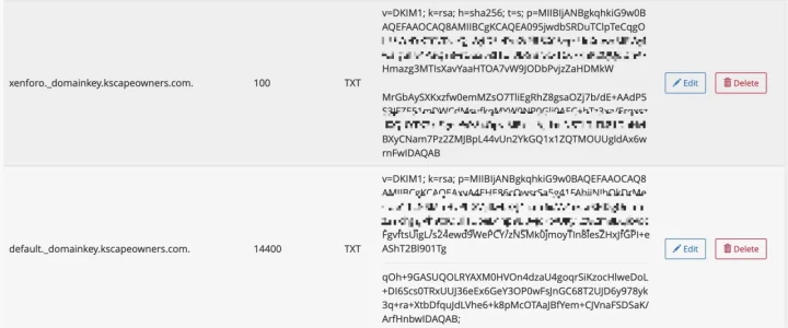

I make a new TXT record with the values supplied by XF's dialog box, using copy and paste so it's exact. New record looks like this:
(part of key deliberately obscured)

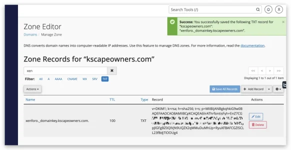

I save that record, cPanel reports success saving it:

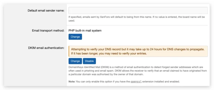

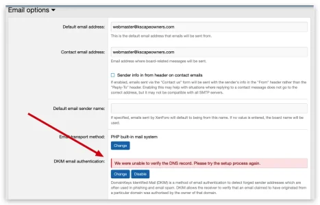

I go back to ACP->email options, and hit the confirm button on newly-generated keys data, and I get to a "Attempting to verify your DNS record..." status:
I wait like 2 days, and this it fails to validate.
The setup instructions seem so simple to follow, I think I'm doing it all right, and yet still it never validates. Tried like 10 times.

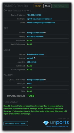

Also, this tool was super helpful for me in testing:
wow, that is a VERY cool tool.
Ran it on my site, and it says my site passed every single check, including that the DKIM record is valid.
Not sure why @Kirby is showing it to not exist... I can see it and this tool can see it. Maybe was a DNS propagation delay?
Anyway, this is another thing that says my site's records are done properly, yet XF still says it doesn't see the record.

THANK YOU all... i finally got it to work! The big clue was in that wonderful tool @Kirby recommended above: easydmarc.
In case others end up here with the same question, here's what fixed it for me:

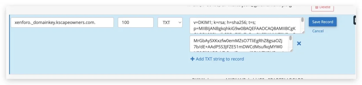

Visiting the page https://easydmarc.com/tools/dkim-lookup?domain=kscapeowners.com&selector=xenforo with my domain and the selector=xenforo set right, it kept saying that my p record wasn't the full 2048 bits it should have been.
That led me to believe that I had to break the TXT record into 2 parts, like I see my hosting company did with my DEFAULT DKIM record was. I guess there's either a limit of like 256 characters in the cPanel interface to making these records, or an actual limit of 256 characters in the TXT record.
When I broke the big string that ACP->options->email options generated for me as my new DKIM record into two parts, and used cpanel to put in the first part and then used the "+ Add TXT string to this record" button, then pasted the 2nd half of the generated key in that box...
and saved the record THAT way,
then verified in cpanel that the combination of the two tXT strings looked right in the DNS record:

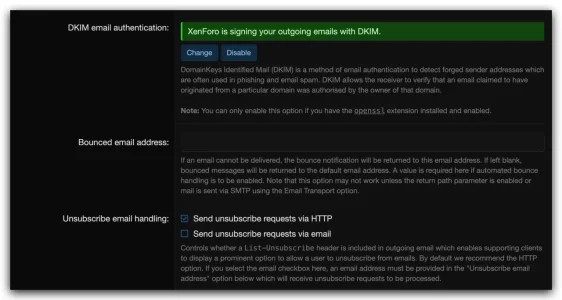

Then finally, XF ACP gave it the green light:
So ultimately, the problem is that XF ACP will generate a 2048-bit key, and it takes multiple TXT records at your nameserver DNS record to handle a 2048-bit key. Break it in half and you're golden.
Many of the other cool tools recommended here, like @briansol's awesome "learndmarc.com" and some others kept telling me my DKIM was coming back as valid because they were only looking at the default DKIM record... they didn't seem to have a way to put in a selector to validate an application-specific DKIM like Xenforo wanted... but that easydmarc page does let you do this. Thanks @Kirby!
Yup, DNS RRs are limited to 255 octets (bytes, "characters")
Many user interfaces (like AutoDNS, Cloudflare, etc.) already handle this "behind the scenes" so you can just paste the value - seems like cPanel isn't that user friendly and you have to split the string manually.
