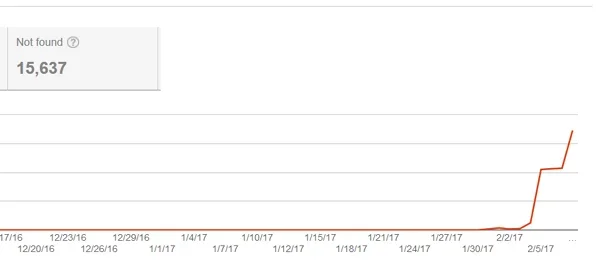

I moved my vbulletin 3.8 to xf about a week ago. My vb install has vbseo installed. The vbseo setting is 1.
Spent four days on this and not getting very far, I've read pretty much every thread on the subject. I now feel like the proverbial monkey with a typewriter, trying everything at random until something works. Traffic is down by 50% likely due to links from search engines ending up at error pages.

The problem with the photos not redirecting is that since my forum is vacation orientated a lot of people illustrate their posts with photos in their trip reports etc. Now the photos don't show because they reference an old url and instead there are lots of empty img tags in their posts, no photos and my 404 error log gets swamped by the missing pics.

Still having a few problems with 404's following my import from VB 3.8
