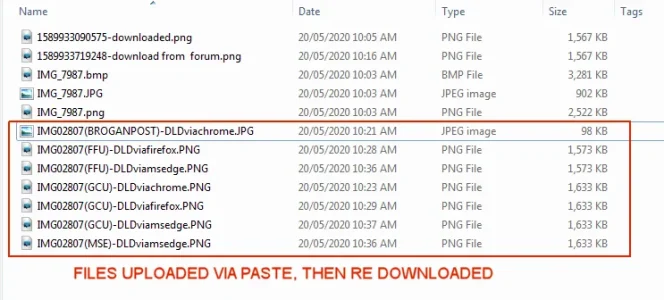

and here are the file sizes.
IMG_7987.xxx = the same original file in 3 formats. The JPG was loaded in Patin Shop Pro and psated straight into the forum from there.
As you can see, the file significantly increases in size from the original JPG file, once uploaded then downloaded from the forum.
The larger the file used, the bigger the blowout.
So the issue is not just with my forum/server/config.

This is how the files show on my PC:
FFU = Firefox Uploaded
GCU = Google Chrome Uploaded
MSE = Microsoft Edge Uploaded
DLD = Dowloaded.
AndyB mentioned to me in PM that the issue might be because files get recreated when pasted as a new PNG file.
Is there a way to change that?
