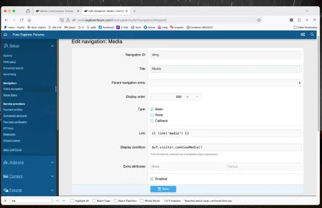

I am trying to change "Media" to "Photos" on the Public Navigation page but it will not let me modify the existing name. What is the trick?

I could not find anything like link nav.media. I did a search for "link" and "nav" to scan all instances of "media" in Phrases, but never found one that controls the name in the Navigation bar.
I guess I'll try developer mode.
$config['development']['enabled'] = true;
This did not allow me to make the change on the Public Navigation page either.
I'm stuck.

I think what you're looking for is
nav.xfmg​
