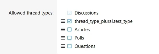

You should now see them here when you go and edit what thread a node can use:

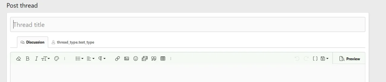

And when you have added that thread type to a node in an post selector
