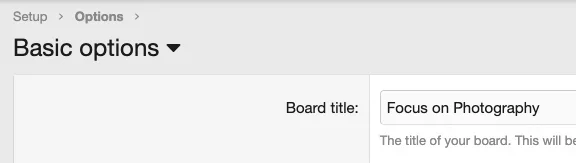

Setup > Options > Basic Options > Board Title
I see I forgot to mention in my OP that the forum's name is filled in there (I edited my OP to add it):

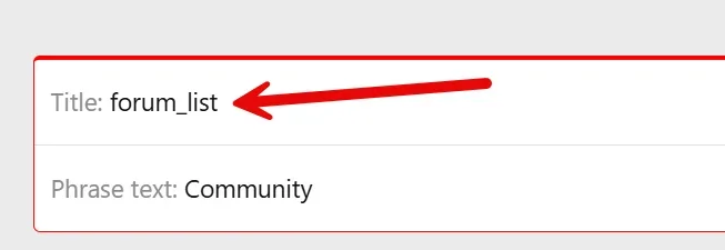

Admin Panel -> Appearance -> Languages & phrases -> Phrases -> forum_list

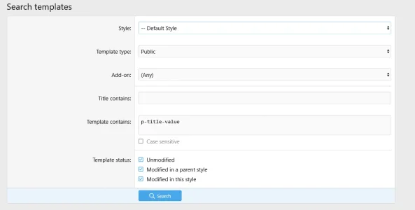

If you are still looking, try searching your templates. Add p-title-value to the template contains criteria. It will list any templates and you can see if any have been amended.
It may be you have edited the PAGE_CONTAINER template and replaced <h1 class="p-title-value">{$h1}</h1> with <h1 class="p-title-value">Forum list</h1>

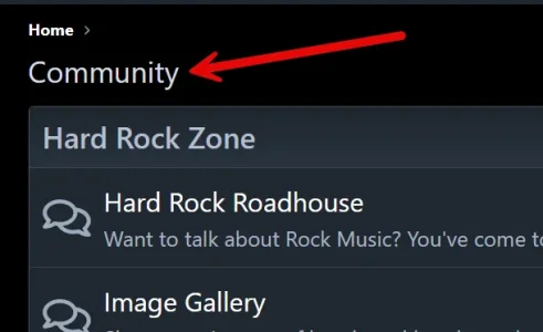

Search phrases for Forum List - use translate option and change the first Forum List entry to what you want. I changed mine to 'Community'
Funny, I flipped through this I don't know how many times because the phrase text is equal to the master value (both "Forum list" and there's no revert button so if I'm correct I couldn't have modified it here. And the demo shows the same, and yet displays the board title. But yes, I could definitely do this to change it again to something else. Thanks. Could maybe be a better way even than modifying a template, less prone to causing problems with software updates?

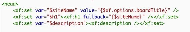

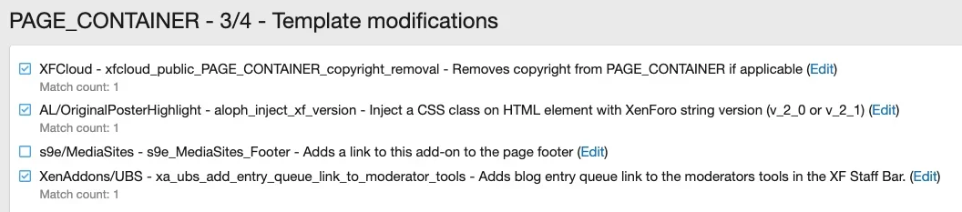

Searching templates on p-title-value yields some results but only two with modifications: xfmg_media_view (not relevant). The other template is indeed PAGE_CONTAINER with 4 modifications and none seem relevant:
PAGE_CONTAINER:
But when I look in the browser's dev mode and compare my forum to the demo I opened, I see this:
My forum:
The demo:
So all things being equal (except for non-relevant modifications) what accounts for that difference?
