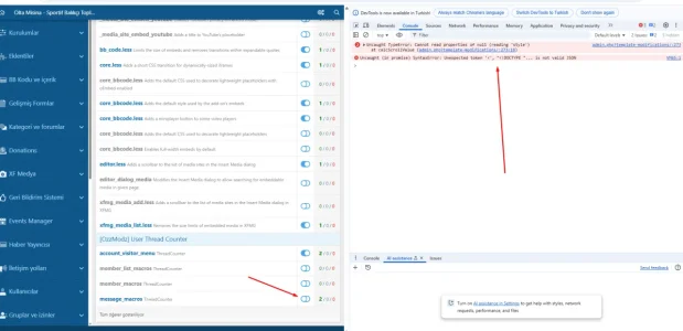

I close the marked area in the image, but when I refresh the page, it returns to the open position again. What could cause this? could it be because I made changes to the message_macros template?

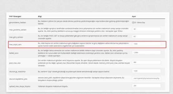

Yeah, a console error happens very likely when you hit your max input vars limit.
You should then be able to use the on/off switch for in the upper area of the list, but not at the end; at least that's the behavior on my site.
